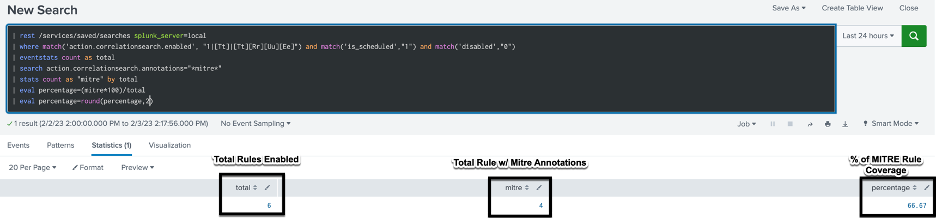

To determine your coverage with the MITRE ATT&CK framework, use the following query to find the percentage of coverage in your current enabled correlation rules:
| rest /services/saved/searches splunk_server=local
| where match('action.correlationsearch.enabled', "1|[Tt]|[Tt][Rr][Uu][Ee]") and match('is_scheduled',"1") and match('disabled',"0")
| eventstats count as total
| search action.correlationsearch.annotations="*mitre*"
| stats count as "mitre" by total
| eval percentage=(mitre*100)/total
| eval percentage=round(percentage,2)
The search will return results that look like this:
From here you'll need to learn the details of the TTPs that are being detected within your rules. There are two ways you can determine this - by searching for tactic and technique coverage or by using visualizations to determine TTP coverage.
