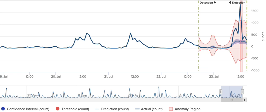

Running this search gives you a statistics table by default. To see an Anomaly Detection Chart, switch to the Visualization tab and select that chart type. It plots the observed series against the forecast band and shades any anomaly regions, which makes it much faster to judge the effect of a tuning change than reading anomaly_state values in a table.
The screenshots below show the effect of changing multiplier. The search and conf_interval=60 are the same in both; only the multiplier value changes.
With multiplier=20, no anomaly is flagged. The red threshold band is wide enough that even the sharp rise in blocked queries stays within tolerance.
Anomaly Detection Chart with multiplier=20 showing no anomaly flagged. The threshold band is wide enough that the rise in blocked queries stays within tolerance.
With multiplier=10, an anomaly region appears (shown as a red rectangle). The tighter threshold band means the same rise in blocked queries now crosses it.
Anomaly Detection Chart with multiplier=10 showing an anomaly region highlighted in red. The tighter threshold band means the same rise in blocked queries now crosses it.
This is the core tuning loop for this use case: leave conf_interval alone, and adjust multiplier until the detection rate matches what your environment needs.
