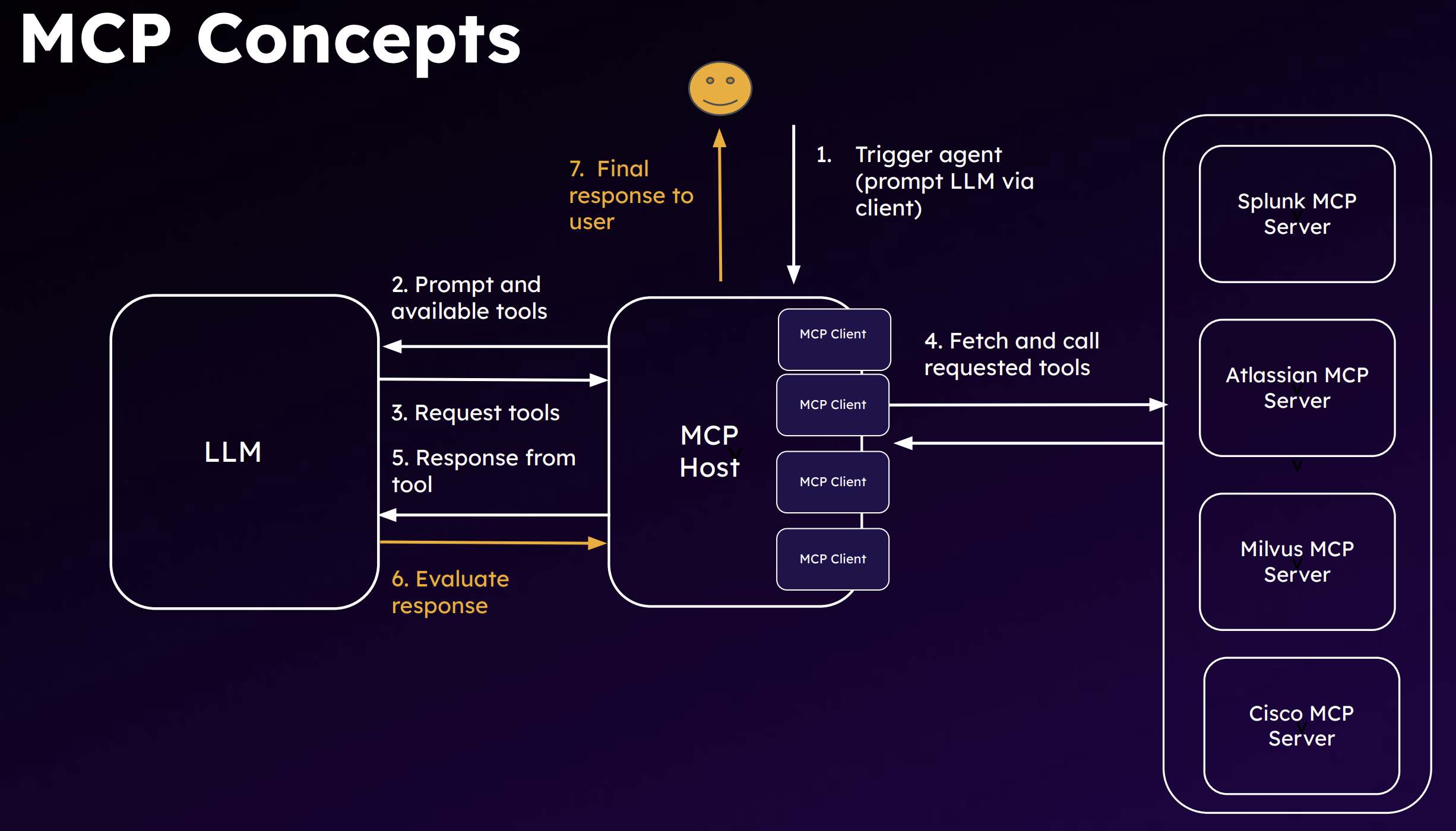

MCP—model context protocol—enables LLMs to connect to services so that you can create AI agents to complete more custom tasks. It is a lightweight, secure, two-way connection bridge to access external tools, databases, and functions. It converts requests from AI models into requests that those other services can understand and then translates those results back again. secure two-way connectors between data and AI tools. The two main parts are:
MCP Client
  • Connects to MCP Server through JSON-RPC 2.0 messaging
  • Integrates to LLM models and orchestrates
  • Handles user request/responses
  • Examples: Claude Desktop, gemini-cli, Amazon-Q
MCP Server
  • Connects to tools/functions
  • Security gateway
  • Examples: Splunk MCP Server, AWS MCP Servers, Github MCP Servers
A sample workflow is show in the following diagram.

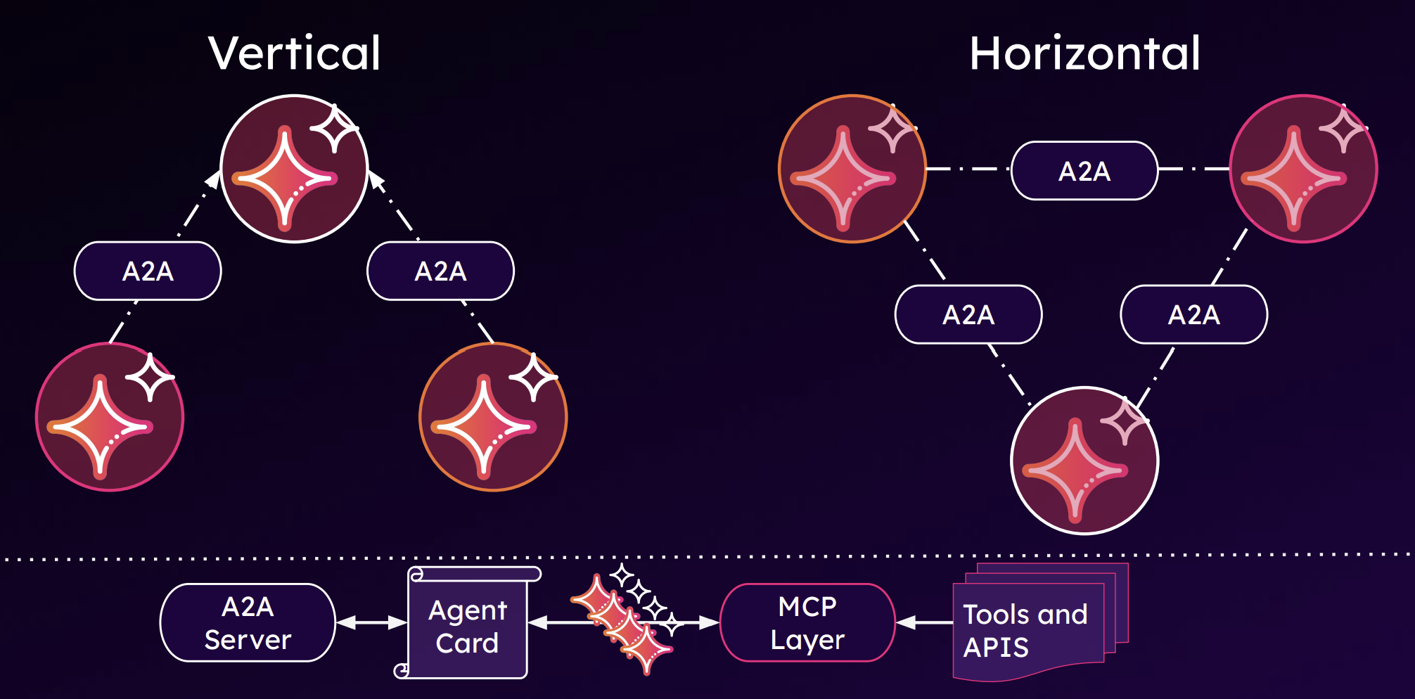

Multi-agent architectures
Multi-agent architectures are what will truly empower autonomous networks, and there are many ways to architect multiple agents, but the most basic way is to consider the following two.
  • Vertical has a teacher/orchestrator
  • Horizontal is symbiotic, no hierarchy for execution
Both use agent-to-agent (A2A) communication, shown in the bottom of the diagram below.
When building a multi-agent architecture, consider the following:
  • Pros: Scalability, adaptability, collaboration, efficiency, and autonomous decision-making
  • Cons: Coordination complexities, Human-agent interactions (where does the human belong?), security, lack of standardization (though A2A is improving this drawback), and resource intensive (which is probably the biggest con)
