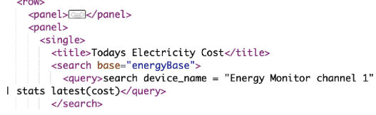

Reference a saved search
A second option for building a base search is to reference a saved search. Saved searches are easily reusable across many dashboards, and if they run on an interval, the dashboard always displays the latest information. This example has a search ID of "energyBase" and references the saved search "Device Energy Consumption".
Use the search base attribute to reference the base search ID. This example also adds a stats command to the base search.
