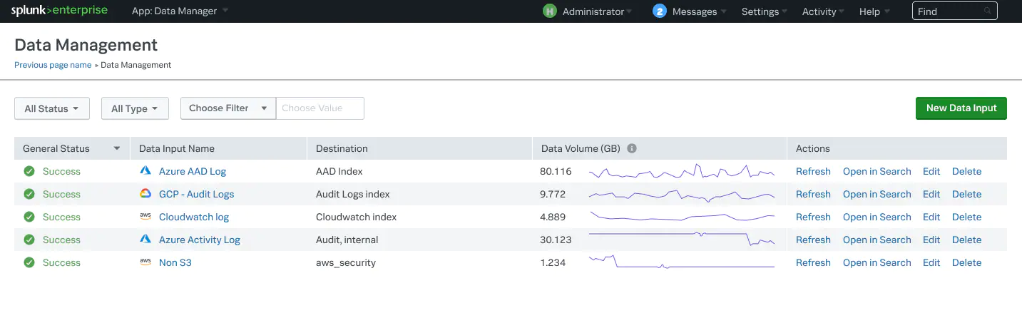

After the stackset has been created, use the Data Manager console to review and monitor the health of your AWS data inputs. The Data Management screen provides a graphical interface to monitor the state of the input deployments. An “In Progress” message indicates that an input is still being provisioned through CloudFormation and a healthy input will be in the “Success” status. The throughput field should start populating and the “Last Received” field should begin updating as well.
The “AWS Inputs Health” dashboard provides the next level of detail, showing input status by data source and account. The filtering capability provides a way to systematically review the configured inputs against your plan.
