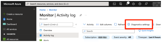

1. Type monitor in the search bar and click the Monitor service.
2. Click Activity log.
3. Click the Diagnostics settings button.

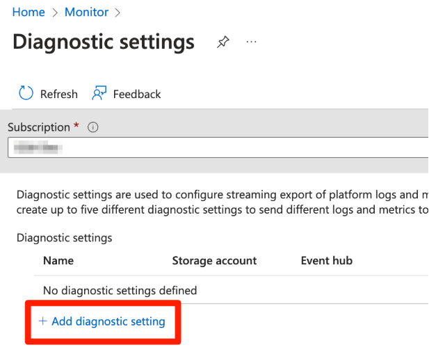

4. Click Add diagnostic setting.
5. Give the diagnostic setting a name, select which log categories you want to export to the Event Hub in the Categories section, and select Stream to an event hub in the Destination section. When selecting the Stream to an event hub option, select the Event Hub Namespace.
6. Click Save.

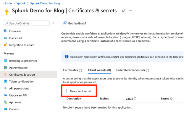

6. Click Certificates & secrets as shown in the screenshot in step 5, above. Then click the New client secret button.
7. Provide a description and expiration date, and then click the Add button.
8. After the secret is created, the value will be displayed in the Azure portal. The Secret ID is not used. This is the only time you will see the value in plain text, so make a copy of it now as you will need it later. If you lose this value, you will need to create a new secret.

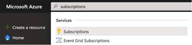

  1. Type subscriptions in the search bar and click the Subscriptions service.
