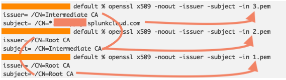

Build your certificate chain
  1. Take all of the certificate blocks you have and place them into separate files. They’re only text, so you don't need any programs other than a text editor.
  2. Run the following command against each of the separated certificate files: openssl x509 -noout -issuer -subject -in somecert.pem
  3. Find the certificate with the subject that matches the server you’re working on. This is your leaf (client/server) certificate.
  4. Find the certificate where the subject matches the issuer of the leaf certificate identified in the previous step.
    • If the issuer and subject of this certificate are the same, then you signed the leaf certificate with a root certificate. This isn’t recommended, but it is allowed. Go to step 6.
    • If the issuer and subject of this certificate are different, then you’ve identified the intermediate certificate.
  5. Find the certificate where the subject matches the issuer of the intermediate certificate identified in the previous step. This is the root certificate, which means you have a complete chain. If the issuer and subject are different, then you either:
    • have multiple intermediates (this is fine - repeat this process until you reach the root certificate)
    • are missing the root certificate (in which case, you cannot proceed until you have it)
  6. Put the leaf certificate followed by the private key for that leaf into a single file. There should only be two blocks of text inside this file, meaning do not include issuer certificates. This file is your clientCert or serverCert.
  7. Combine the intermediate(s) and root into a single file. Put these in order based on what you discovered in step 5. Typically you’ll have an intermediate followed by the root and nothing else. If you have multiple intermediates, then put them in order. In other words, if X issued Y and Y issued Z, then the order is Z at the top, Y in the middle, and X at the bottom. No private keys or leafs should go in this file. This is your sslRootCAPath.
  8. To validate this programmatically, refer to Verify your certificate chain.
In the output above, you can see that 3.pem is the leaf certificate, 2.pem is the intermediate certificate that signed the leaf certificate, and 1.pem is the root certificate that signed the intermediate certificate. The root is self signed, so you have the full chain and stop there. The contents of 1.pem and 2.pem will be for sslRootCAPath, and the contents of 3.pem will be your client/serverCert, depending on what you’re configuring.

    2. Validate your certificates and files
    Before you proceed with any TLS implementation, it is critical to perform the following verification to ensure you have the correct certificates and that everything is valid. If something fails at any one of these steps, do not proceed. Go back to the relevant areas of this guide and make changes to ensure that failures do not occur before you move ahead.
    1. View the certificates. Check that the CN/SAN looks right and that the certificate has the appropriate before/after. Do this for leaf and CA certificates.
    2. Verify that the private key and certificate match for every client/serverCert you will put in place.
    3. Combine your certificates and keys into the appropriate files.
    4. Validate the certificate chain.

    Self-signed certificate in chain
    As part of the output from an attempt to openssl s_client, this message indicates that one of the certificates within the chain is self-signed. That is, the subject of the certificate is the same as the issuer. In order for OpenSSL to validate this, the self-signed certificate must be explicitly trusted by using the -CAfile option. The equivalent in Splunk platform would be adding this to the sslRootCAPath.
    Certificate chain
     0 s:/C=US/ST=California/L=San Francisco/O=Splunk Inc/OU=Cloudworks/CN=*.cloud-architects.splunkcloud.com
       i:/C=US/ST=California/L=San Francisco/O=Splunk Inc/OU=Cloudworks/CN=Splunk Cloud Certificate Authority
     1 s:/C=US/ST=California/L=San Francisco/O=Splunk Inc/OU=Cloudworks/CN=Splunk Cloud Certificate Authority
    Lines 4-5 show that the signing certificate (the issuer) for the leaf certificate on line 2, has the same subject as issuer, indicating that this is a self-signed certificate.
