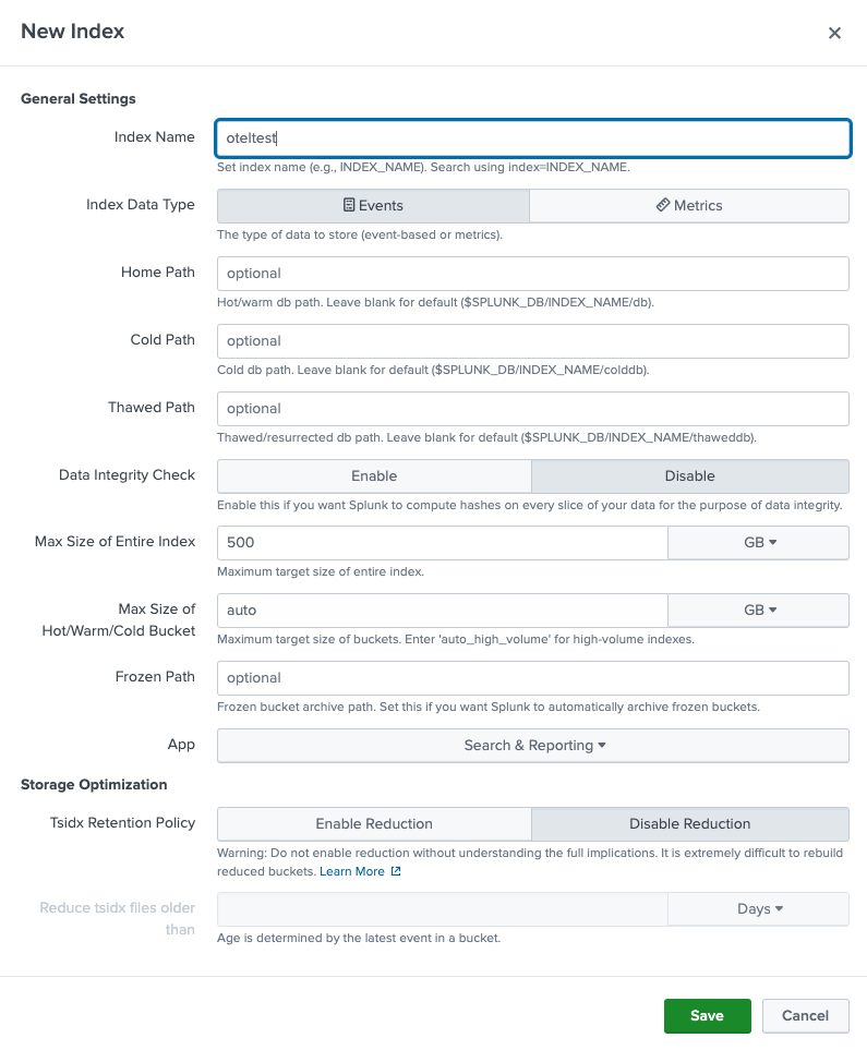

Splunk platform
The following steps create a Splunk platform index and HEC token. You must have administrative permissions to perform these operations. The index name and HEC token will be referenced in later steps.
Create the index
  1. In the top right corner, click the Settings menu.
  2. Under the Data column, click Indexes.
  3. In the top right corner, click New Index.
  4. In the Index Name field, enter "oteltest".
  5. Click Save.
