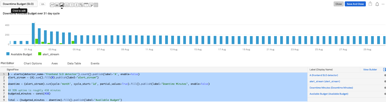

Create an error budget chart
Here is an example of a SignalFlow function to create a chart that tracks alert minutes. You can also specify to have the chart reset monthly so you know if your error budget for the month has been used up.
## Chart based on detector firing
AM = alerts(detector_name='THIS IS MY DETECTOR NAME').count().publish(label='AM', enable=False)
alert_stream = (AM).sum().publish(label="alert_stream")
downtime = alert_stream.sum(cycle='month', partial_values=True).fill().publish(label="Downtime Minutes")
## 99% uptime is roughly 438 minutes
budgeted_minutes = const(438)
Total = (budgeted_minutes - downtime).fill().publish(label="Available Budget")
This table provides an explanation of what each part of this function achieves. You can adjust this example based on the specifics of your environment.
SignalFlow function Explanation
Define a metric stream from the detector you created previously. Take the alert stream and sum it.
Create a downtime minutes stream. Sum the summed alert stream with a cycle= of month/week/etc and allow partial_values just in case. Use fill() to fill any empty data points with the last value.
budgeted_minutes = const(438) Create a constant for the number of minutes in our “error budget” or “downtime budget”.
Create the total available budget. Subtract the downtime stream from the budgeted minutes constant value. Use fill() to fill any empty data points with the last value.

The resulting chart looks like this:
Example charting of Alert Minutes
