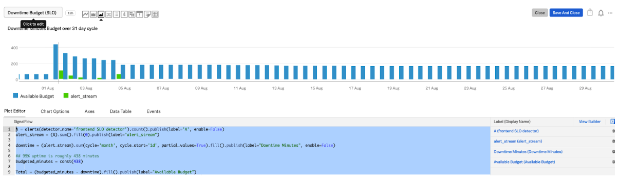

Create an error budget chart
Here is an example of a SignalFlow function to create a chart that tracks alert minutes. You can also specify to have the chart reset monthly so you know if your error budget for the month has been used up.
## Chart based on detector firing AM = alerts(detector_name='THIS IS MY DETECTOR NAME').count().publish(label='AM', enable=False) alert_stream = (AM).sum().publish(label="alert_stream") downtime = alert_stream.sum(cycle='month', partial_values=True).fill().publish(label="Downtime Minutes") ## 99% uptime is roughly 438 minutes budgeted_minutes = const(438) Total = (budgeted_minutes - downtime).fill().publish(label="Available Budget")

The resulting chart looks like this:
