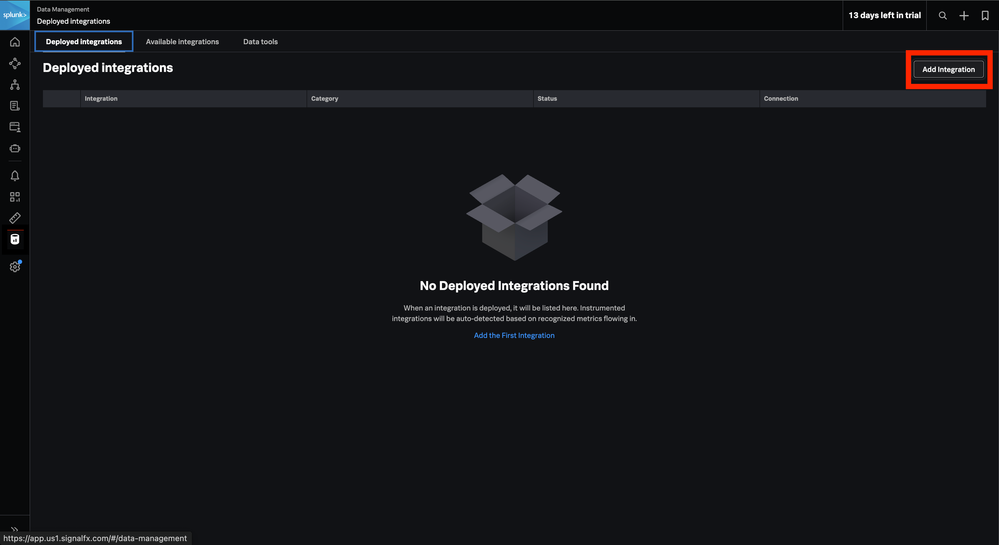

First, log into your Splunk Observability Cloud account. From the home page, open up the Data Management section on the left toolbar.
Select Add Integration, located at the top right of the screen.

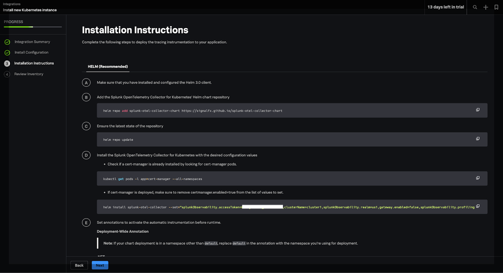

Moving to the next step, we’ll use Helm (3.x) to install the Collector following the steps in the Installation Instructions.

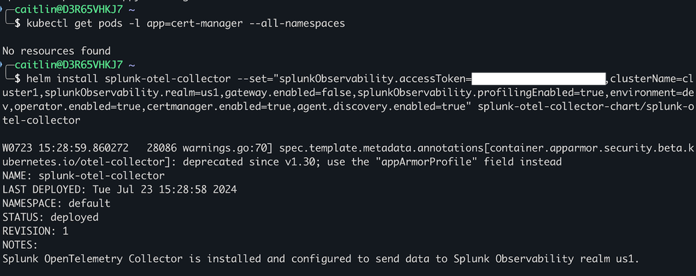

The output from the kubectl get pods and the helm install splunk-otel-collector commands should look something like this.
