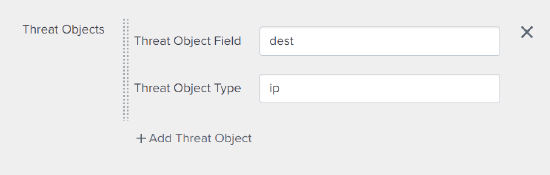

- Threat Objects
- Allow you to associate possible Indicators of Compromise (IOC) with an analytic
- Create a new vector in security that allows you to understand “behavior” from an IOC perspective
- Lower the barrier for localized threat hunting
- Aid in the investigative process
- Allow you to attach many possible IOCs to the notables that get sent to Splunk SOAR
By using the Threat Objects feature in your risk rules, you can build a local repository of Indicators of Compromise (IoC) or Indicators of Behavior (IoB). This threat data is extremely important due to its high relevance to investigative, threat intelligence, and especially threat hunting activities within the SOC.

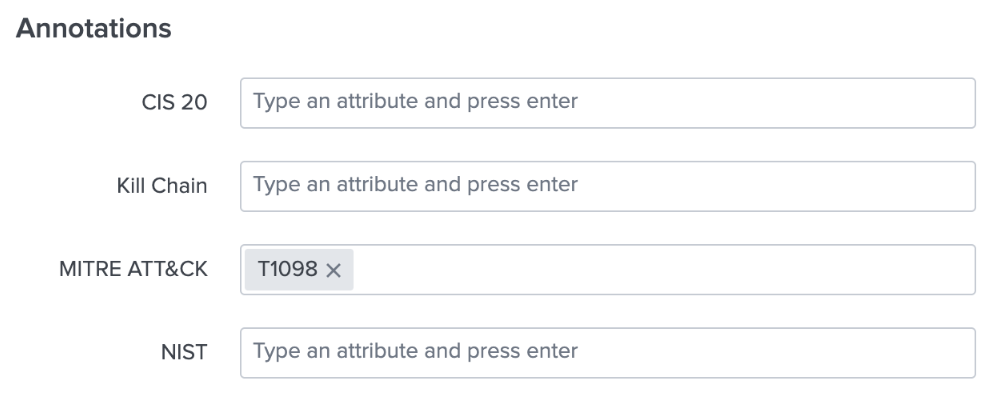

- Modify existing correlation searches in ES.
- Add MITRE ATT&CK technique. In the top navigation bar in Splunk Enterprise Security, click Configure > Content > Content Management, then filter by Type=Correlation Search. Select the correlation search you would like to modify and locate the annotations section. Refer to the Mitre ATT&CK matrix and locate the technique or subtechnique that best aligns with your correlation search. Enter the technique number into the annotations.

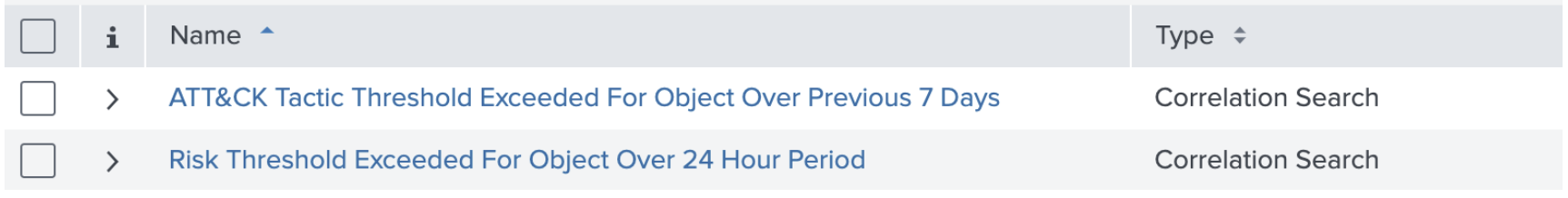

- Enable the built-in aggregation rules. There are two correlation searches included in ES that are designed to create risk notables.
The “ATT&CK Tactic Threshold Exceeded” detection looks for risk objects that have seen multiple attack techniques over a 7 day window. Consider changing the “where” clause to make it more or less sensitive.
For example:| where mitre_tactic_id_count >= 2 and source_count >= 2
On a similar note, look at the “Risk Threshold Exceeded” detection and consider what changes to make. One suggestion is to change it to a longer time span to help find low-and-slow attacks. You can also adjust the risk threshold as needed.

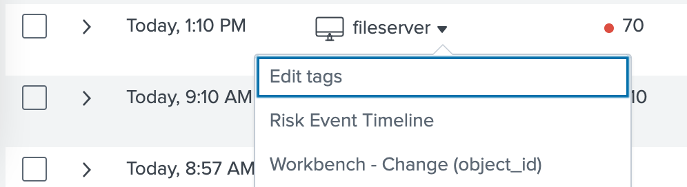

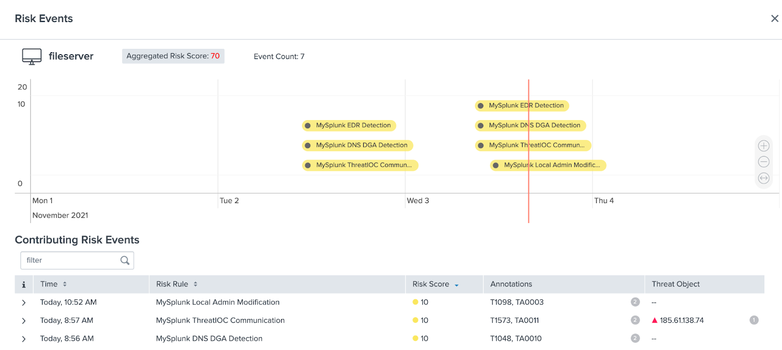

- Update the incident review settings. On the ES Incident Review page, you should now see the “Risk notables” type when the above alerts trigger.
You will also be able to view the risk event timeline from the risk object.
This timeline provides a powerful view in order to begin an investigation and visualize all risk events.If you have been using Splunk Enterprise Security for a while and have previously customized the incident review settings, you might not see these new columns. To add those back in, go to Configure > Incident Management > Incident Review Settings. Review the columns you have and consider adding back in any fields below that you might need.
