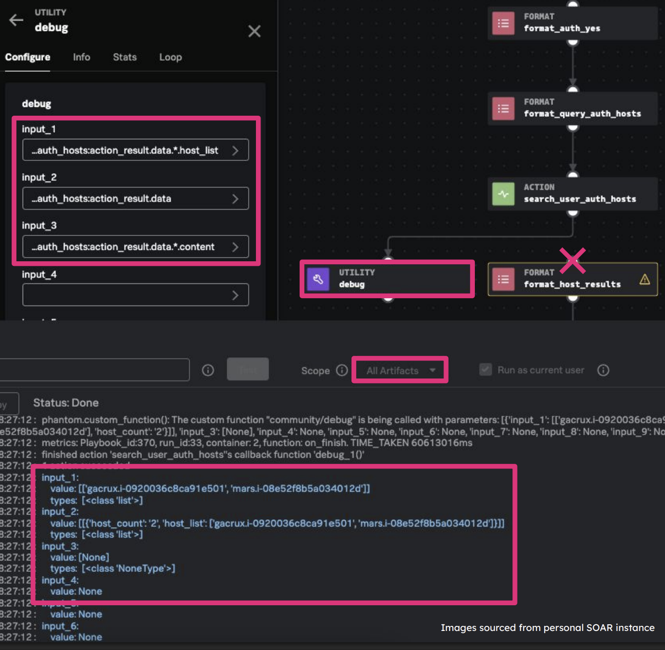

Debugging
The utility block has a debug function to pass in up to 10 values. The Playbook Debugger window is used to monitor playbook execution and output as it runs. This is extremely useful when determining how to use the output of a previous block in the next step of the automation.
For example, you've just run an action block to perform a remote search of a Splunk platform instance through SPL and it has returned results, but you don't know how to reference these results to format and output them into the container notes. Selecting an input_x field within the debug block provides a preview of upstream fields; however, there will be many to choose from. Select up to 10 and run the playbook to monitor the output in order to determine the correct field to reference.
Some things to note when using this utility:
  • Provide an artifact ID and always set the scope to All Artifacts
  • Disconnect downstream blocks while debugging to prevent them running unnecessarily
  • Use phantom.debug() in custom code blocks for even more control
For more information, see Debug playbooks in Splunk SOAR (On-Premises or Cloud).
Using the floating debugger
To optimize playbook debugging, keep a floating debugger debug block close to wherever you are actively developing a playbook. In line with good coding practices, this block should have a name, description, and notes. Follow these guidelines when using the floating debugger:
  • Connect the utility in-line when running the playbook debugger
  • Disconnect downstream blocks to speed up execution
  • Add up inputs in bulk to assist with locating the fields relevant to your playbook
