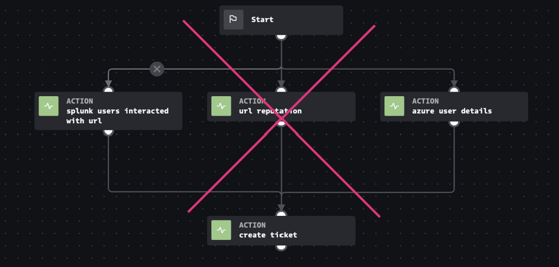

Use List Zip to combine results
How can you link multiple upstream action blocks together in a single action block? For example, if you have a playbook with 3 action blocks, and 5 values come into that playbook, if the final action is to create a ticket, you'll end up with 125 tickets (5^3).
List zip, another custom function, can link lists of multiple sizes into a uniform number of custom function results. In our example, adding the list_zip utility leaves us with only five tickets total, one for each user.

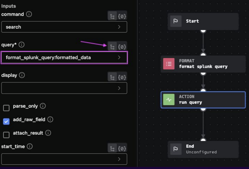

Use the right formatting option
When should you use formatted input versus format blocks for the data you want to bring into a playbook?
The formatted input toggle is great if you want to pass in a list one time or pass in a single value.
The format block is best if you want to pass in a note multiple times for a specific item in a list? Formatting data gives you all the output at a single time, while formatted data.* outputs the format separately for each item found.
