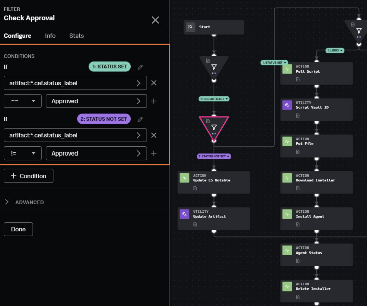

Filter block: Running an adaptive response on an ES Notable re-opens the same container it originally created. To prevent failed automation or automation loops, this filter block checks whether an artifact is marked as old_artifactand prevents SOAR from running automation on old artifacts in the container.Filter.png
Filter block: Next we check if an artifact contains the 'approved' field under status_label. If so, see the next filter block. If not, see the next action block.
This step is optional and stems from the automated approval management playbook example.Filter2.png
Filter block: Next we check the operating system to determine the correct path. This could include additional parameters, such as test versus production environments.

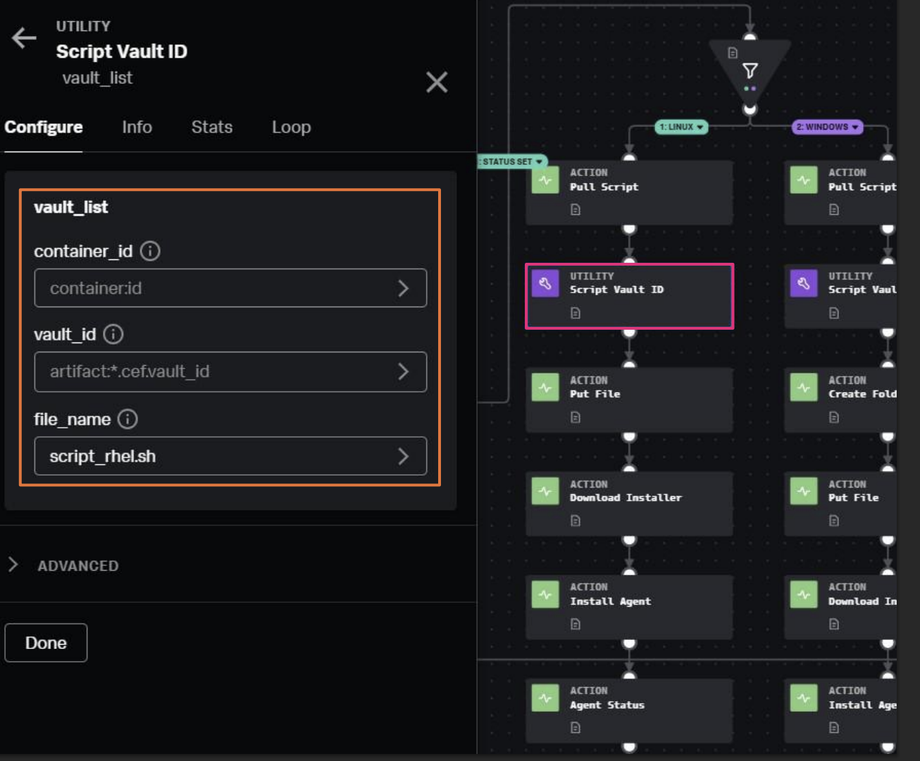

Utility block: Use the vault_list utility to add the script pulled by the previous block into the vault for the container. This is required in order to move the script between SOAR and the endpoint.Utility.png
