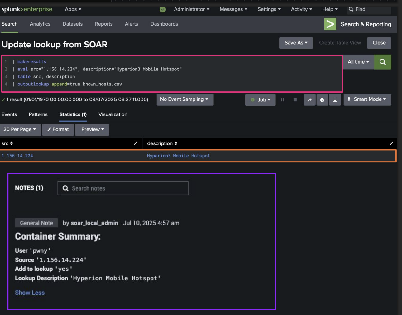

We can now configure a path based on the prompt response. In this example use case, we have selected Yes to add the unknown user to the known user lookup table.
To manipulate the lookup table, we can write the SPL to create a search that will output into the lookup table with the | outputlookupcommand.
In this case, the full search would be presented as:
| makeresults
| eval src="{0}", decription="{1}"
| table src, description
| outputlookup append=true known_hosts.csv
We can now pass this SPL into an action block with a leading |makeresultscommand.
After running this branch, the data is written to a Splunk lookup table from within SOAR with zero custom code. Additionally, SOAR is updated with the same information.
The following screenshot shows a representation of how this search would look from the perspective of the Splunk instance, as well as the container summary after the lookup table as been appended.
