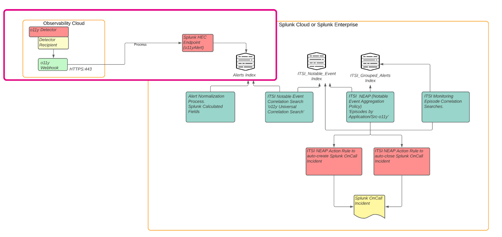

The diagram below shows the overarching architecture for the integration.
The scope for this article is surrounded by the pink box in the diagram. The boxed area shows that Splunk Observability Cloud alerts are sent to Splunk Cloud Platform or Splunk Enterprise via a webhook, configured as a recipient in the Splunk Observability Cloud detectors. The Splunk Observability Cloud alert events are processed through a Splunk Cloud Platform or Splunk Enterprise HTTP Event Collector (HEC) endpoint, and stored in a custom index.

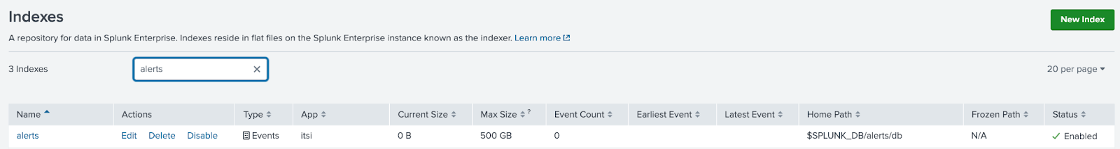

1. Set up the event index
Create an events-based index. Consult the Docs for detailed instructions on how to do this in Splunk Cloud Platform and Splunk Enterprise.
You should follow appropriate naming standards for the index name. This example uses the name "alerts".

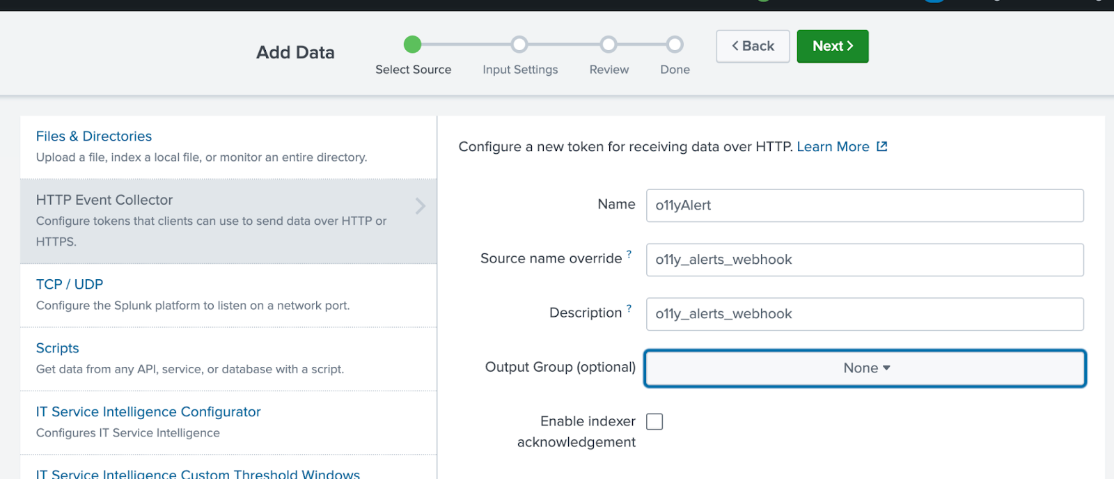

2. Set up the HTTP Event Collector (HEC) endpoint
  1. Navigate to Settings > Data Inputs > HTTP Event Collector.
  2. In Select Source, create a new token named "o11y_alerts_webhook" with a source name of "o11y_alerts_webhook", then click Next.

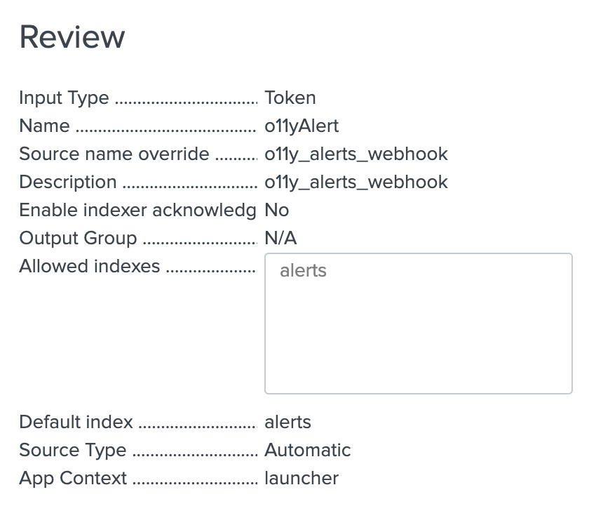

  3. In Input Settings, leave the Source type field as it is. Add “alerts” to the list of allowed indexes, change the default index to “alerts”, then click Review.
  4. Verify the settings are correct and click Submit. Otherwise, click < to make changes.
